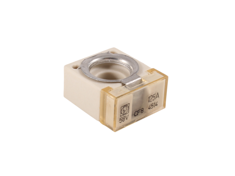

Sorry guys after having a good school through I now found the photo I needed. My problem now is where do I buy the fuse from in the photo. Its the white thing withe the black strip on the middle I need right? I've tried searching but I don't know what to type in, someone please help a girl out here 🙏🏾🙏🏾🙏🏾

Have you tried your local Mercedes parts Dept for the fuse? 🤔

I bought 2 of them from the local MB dealer (they are quite expensive) but in the meantime I had fixed the one that was blown. I bought blade fuses from Halfords for like a a few quid and enlarged the holes in the nearest one in terms of Amps and then bend it in place in the plastic fixing where the old blade went.
worked like a charm and a fraction of the cost.
Also MB dealers have no clue which fuse is for your car. They list both 75A and 120A as suitable and will tell you take either one.... anyone can tell this is a massive difference.
