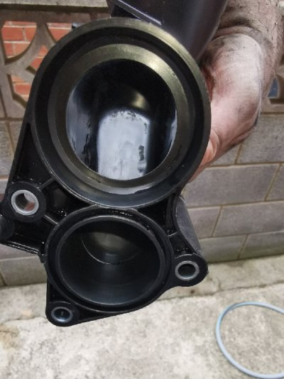

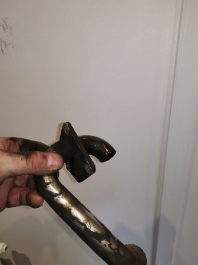

Pulled the front egr pipe and the mounting as well, decided that while the weather was nice and sunny ( didn't bloody last) i would get this done.
Removed all the relative connectors and bolts as usual, need to get a new oring for the aluminium pipe that connects to the turbo, it was old and snapped.
The throttle housing and egr pipe were stinking and needed an exterior clean, and then i got to see the insides.
The egr pipe was coated with carbon build up and needed to be cleaned out, the dual pipe mounting was really bad and also needed cleaning out.
This took most of the day to get cleaned up, it was stubborn to removem i used various wire brushes, and a screwdriver to scrape clumps out, then spraying with a cleaner and putting some wore wool in and scrubbing the insides. I then got the pressure washer out and blasted it clean, and repeated as neccesary.
In the throttle plastic tube, i made sure i removed the two sensors and the throttle body from it and put them safe. The throttle body/flap needed cleaning and that was also done ( sorry no pics)
I definately need to get the intake manifolds off and cleaned up if this was a sign of build up in there.
Before and after pics as follows ;)

yes, it was't an easy job, large hands in small areas to get things out. But to be able to get rid of that crap was good, also it gives me insight into the condition of the inlet manifolds. I will be taking a week off work to have them done, will upgrade the swirl flap rods with the aluminium ones, new motor, oil cooler seals and a clean in there. Also going to replace the turbo i noticed a little wear on the vanes, the spindle is solid no movement but its worth doing now, I will get a replacement cartridge and fitting kit and re build it. Lot of little jobs to do when the weather finally improves!! Nothing like a clean engine for spotting issues and making MOT time easier for the tester.

if you have had a new egr valve fitted then best to check the front egr pipe also take off the throttle assembly pipes that it links to, i expect they are clogged up. I wish i had taken step by step pictures and made a how to thread. Perhaps in the summer i will take it all off again and check it over, do it then.
