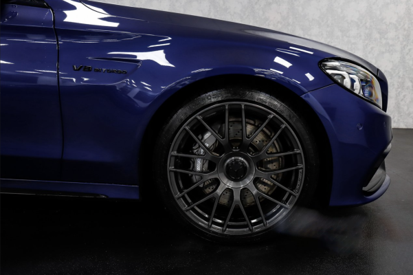

Hi all
Does anyone know if 18s would fit to my 205 c63 wagon currently on stock 19s?
Looking for more rubber for the look (like an M3T wheel and rubber ratio) and maybe some comfort and noise reduction also.
Yes, 18" alloys will fit.
These are currently available from alloy wheels direct.
245x40x18 front and 265x40 rear tyres recommended.
Use the chart in the link above if you buy aftermarket alloys to ensure you have the correct ET (offset)
Thank you
Alternatively could I fit slightly thicker rubber e.g.
Currently has 265/35/19 on the rear, could I fit 265/40/19 tyres on - is there enough clearance?
Same for the front increase 5mm tyre wall.
Any help appreciated
Nope....its 13mm more side wall....so over and inch more diameter.... which is significant.
