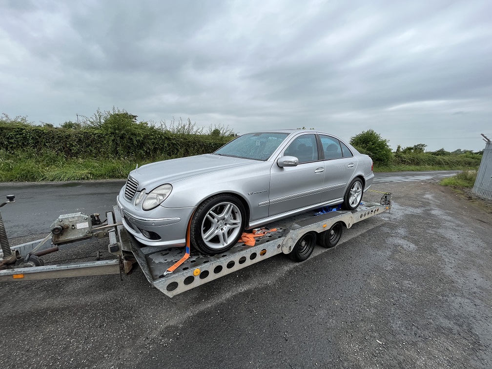

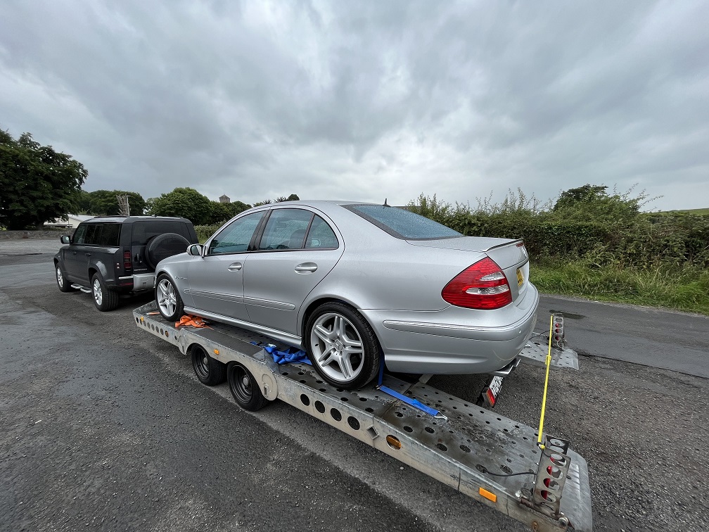

Here’s my new to me, 2003 E55 AMG with 230k miles.
Almost full-service history up to 220k miles, serviced at Mercedes almost every 10k miles for the first 150k miles and by Mercedes independents after. HPI clear and a good MOT history. After a quick inspection and drive, I made a deal for the cheapest E55 I could find. Unfortunately not a very high spec, I wish it had cooled seats!
I thought this might interest people looking for ‘cheap’ AMG’s and what to expect! I will continue to update progress as I go:
Collection day, I thought it was safer and cheaper to collect on a trailer!

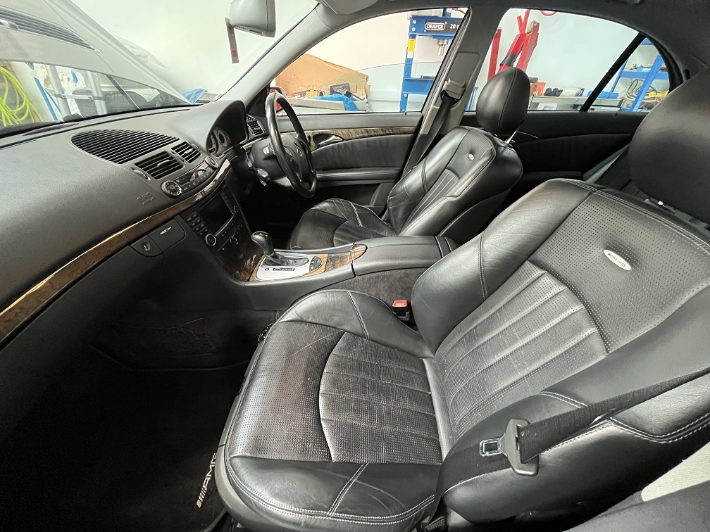

Interior is fairly good, clean and doesn't really look like 200k+:

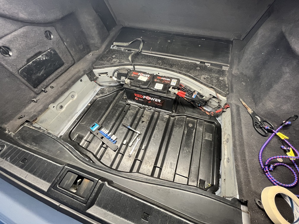

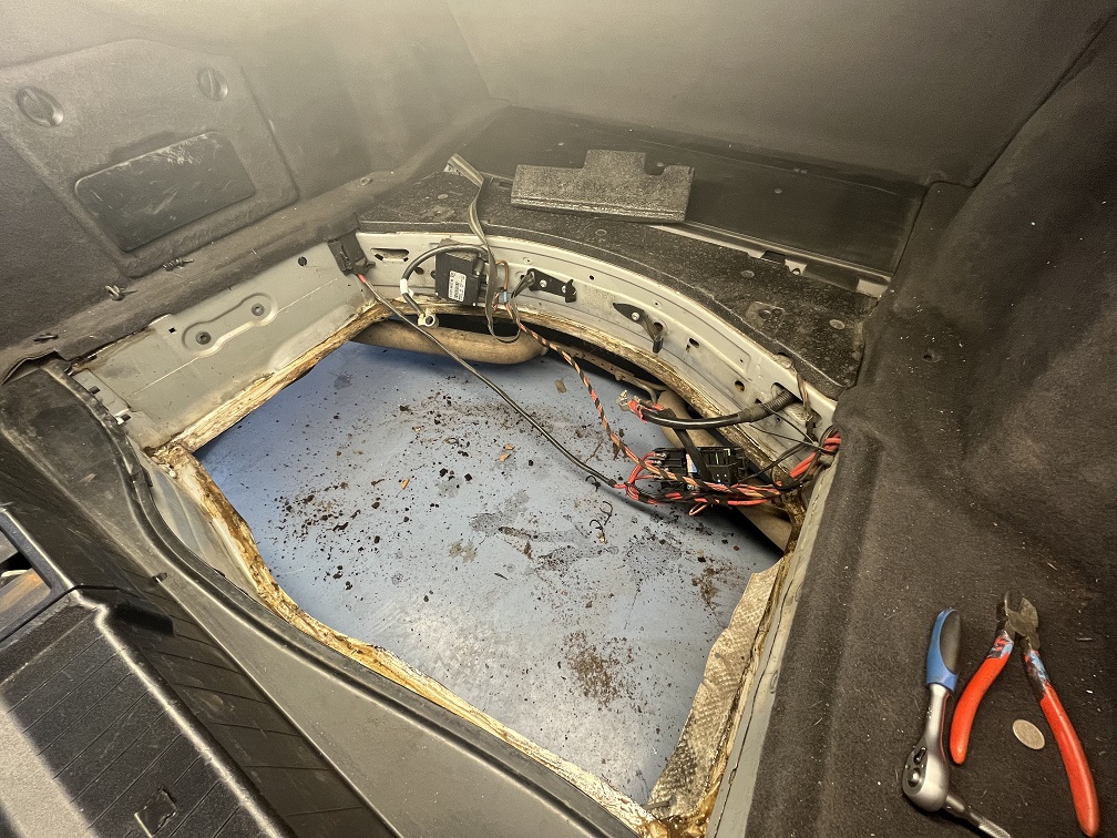

First job I found was water inside the boot. Nothing above the plastic tray seemed wet so I put it down to a bad previous attempt of sealing around the tray. I stripped all back and resealed, hopefully this will keep the water out. While in here I noticed someone had fitted a leisure battery, so swapped this out for a spare battery I had and tidied up the terminal connections. £5 for a tube of sealant.

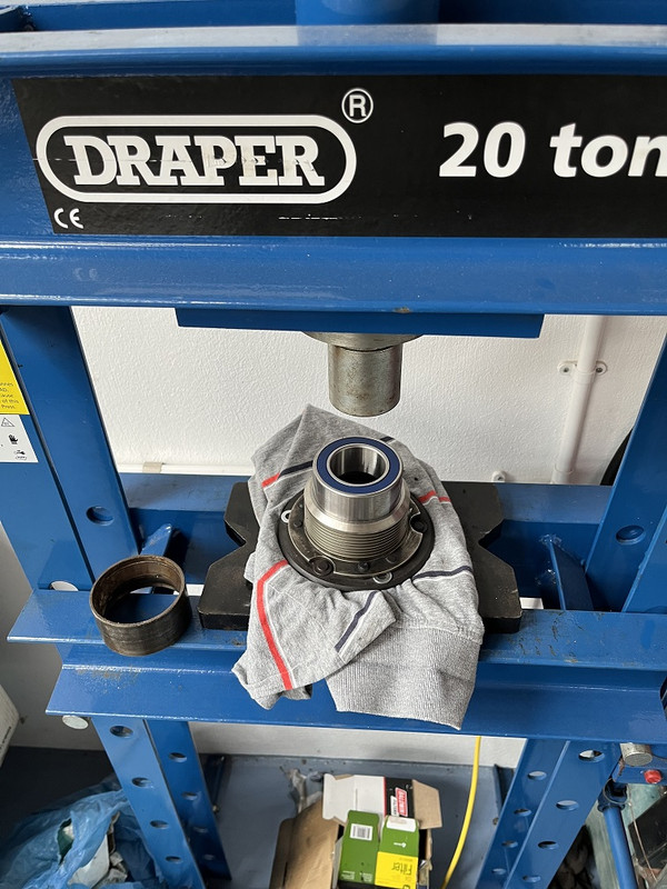

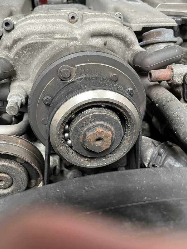

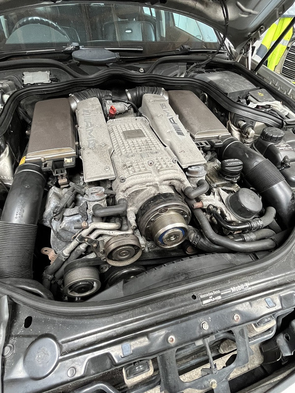

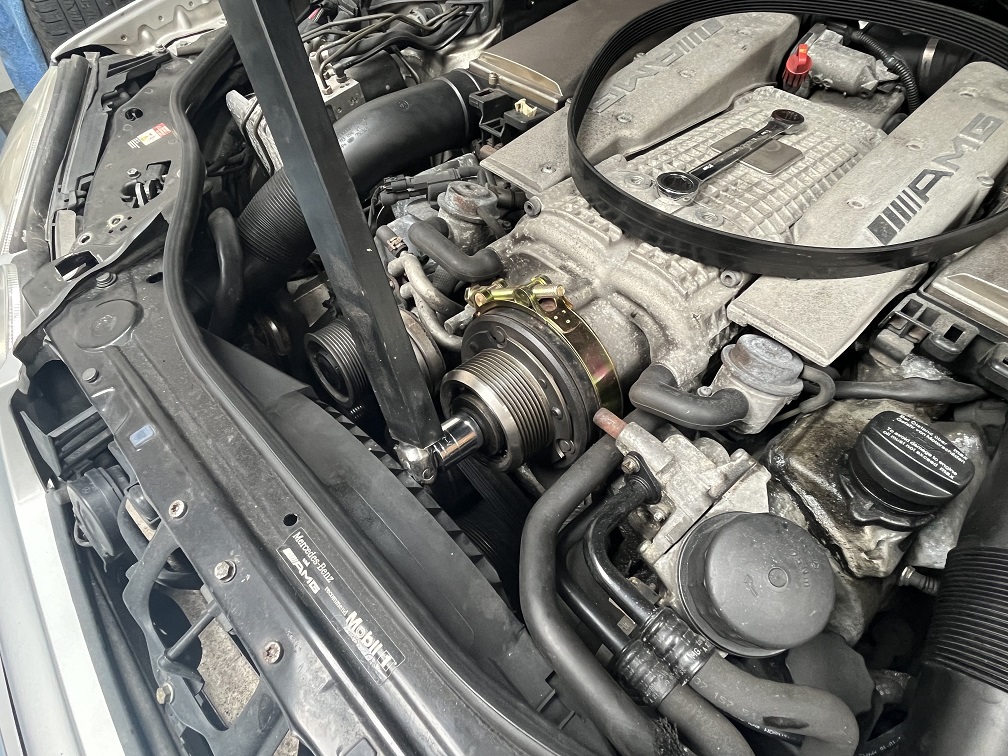

Second job was a new supercharger bearing. How nobody noticed this I can’t understand? I managed to squeeze in a 24mm socket by taking off the four 10mm bolts on the slam panel. Getting the old bearing out was a bit of a pain as the inner part fell out. All back together and sounds much nicer on idle now! £35 for a new bearing.

Could the boot leak be seals around the rear lights? Or the plastic pop rivets holding in plastic trim over the rear wings where the boot closes?

Everything seemed dry on the inside around the lights/carpet so think they're ok.
