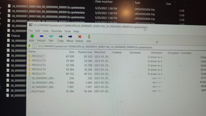

Currently, I've been using the "SD Card for Navigation 2019" V2.5 Map3.1, but I'm trying to update it to the latest version, according to the "COMAND Download Manager", it's V12 with a huge 23.22GB files
I successfully downloaded and copied the file into USB stick (NTFS), the files on the USB stick looks like this
then I put the USB to my car.. nothing happened..... tried both slots (as I read, it should have some kind of pop-up or notification to update the system)
Not sure which part went wrong, or my car system simply doesn't support the USB update like other NTG5.5?
I'm willing to get the Code (PIN) from dealer but I don't even see any pop-up to enter the Code
any advice, please?
I think what you have downloaded is the map data for comand navigation but you have audio 20, I think you need to buy an updated sd card with the new maps for audio 20. I think the maps are garmin but I stand to be corrected.
What you likely have is Audio20 with Garmin Map Pilot navigation on SD-Card. So ignore anything that says 'COMAND'.
You can use the MB Download Manager for Garmin to update the navigation software on the SD-Card, but not the maps data.
If you want to update the maps data, you'll need to buy a new SD-Card (which will also have the newer navigation software).
(For the first 3 years you can get free maps update online from MB, but not after).
EDIT: to clarify, COMAND NTG5.5 and Audio20 NTG5.5 are two very different systems, in spite of the similarity in the name.

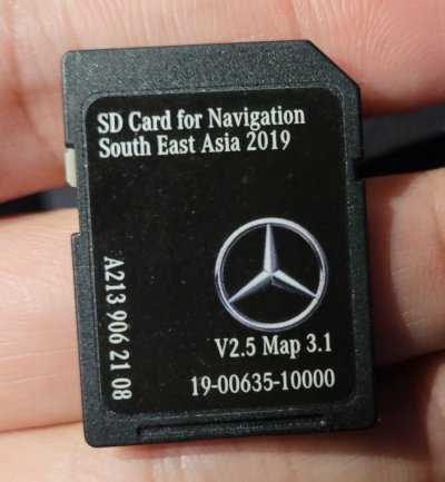

this is the actual photo of SD Card
I also tried to unzip the .updatedata files from the folders I downloaded from COMAND Download Manager and got the same files and folders existed in the current SD Card but I guess it won't simply work by just replacing the old files in the card with new ones though, LoL
As far as I know, a new maps version requires a new SD-Card.
I think that the download manager will only allow you to download updates to the navigation software, and minor updates and corrections to the installed maps.
So what it's probably telling you is that there are no further updates available for the 2019 maps on your SD-Card, i.e. not that a newer map version does not exist.
I think you should simply buy a new SD-Card with 2021 maps. Check again with the dealer - as I said, here in the UK you can buy an Update SD-Card which is much cheaper than the first-time activation SD-Card.
As for replacing the files on the SD-Card... the cards have serial numbers and other elements of copy protection, information on hacking these is probably available elsewhere on the Internet, but won't be discussed here for obvious reasons.
This photo from the Internet is an example of a card that says 'Update':
