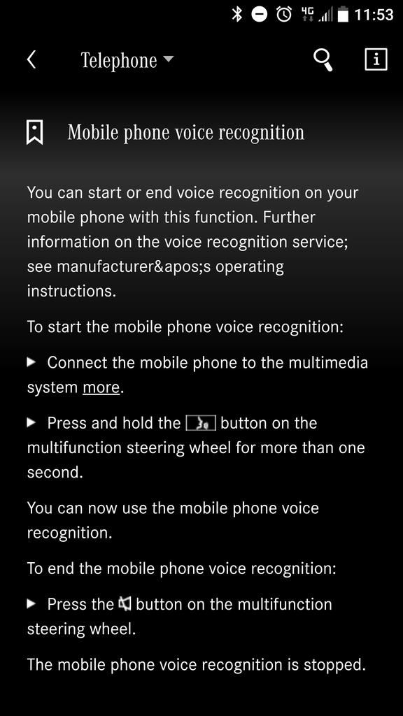

Hi SPILLING.
Sorry you haven't been able to get the voice control for calls working. Did you try the steps outlined in my previous post (#6)?
Mine DEFINITELY works and I have a 2015 Premium Plus A180 so I see no reason why it wouldn't for you. The manual only refers to it in passing and in an obscure section, and there seems to be a lot of confusion about it.
As long as the phone is paired and setup to accept Siri / Google Now activation via a Bluetooth connection (no idea how this works on iPhone) then holding the voice control button for more than a second should bring Siri to life, rather than the Nav.
Let me know how you get on?
EDIT: on the MB guides app go into Audio20-->Telephone-->Mobile phone voice recognition for the relevant section:
