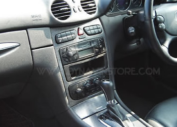

sorry me again will i need single or double din just looking at them now
If you radio looks like this:
Then you can fit either a single or double unit.
E.g.:
