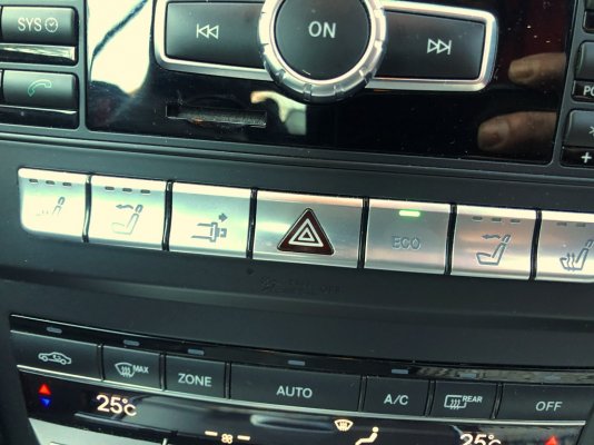

The original battery on my E250 was dated 2014 and began struggling recently to start he car. The stop start function had also stopped working so main battery looked suspect.
Just had a new battery arrive and promptly fitted it. Stop Start is now back to fully working and the Eco button goes green as soon as the car is turned on and before even started.

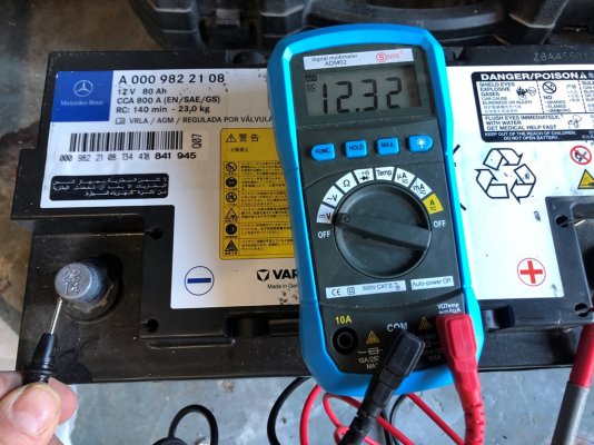

Even after a trickle charge overnight the original battery was only 12.32 volts.
After fitting straight out of the box, the new one was 12.67 volts.
Now with just ignition turned on the ECO button goes straight to green.

So even with a slight variation of voltage, in my case 0.35 volts, was enough to stop the Stop/ Start from working.

That slight change of voltage is the difference between good and duff. 12.7 is about the top end of charged and 12.3 is a battery that might not recover after a charge. It’s just a very small range and is a lot less than you’d expect.

12.0 volts just off charge is on the face of it terrible.
The problem is you can only get a sensible and useful state of charge voltage reading when the battery is rested and under no load. With modern cars the no load criteria is hard to determine without disconnecting the battery. A fully charged AGM should then be more like 12.9 volts and a non AGM 12.7 volts.
It would have been interesting to know what that new out of the box AGM was before it was fitted as 12.67 volts is not fully charged even if it did fix the stop start.

The original battery was a Varta AGM, it really only started to struggle these last few weeks going down to 11.7 volts a few days after an overnight smart charging, just before it was changed it was starting perfectly at 12.3 volts. I was not worried about the stop/start as I would always turn it off, but it was a good indicator of battery charge.
Out of the box, my new AGM Varta was 12.6 volts before it was fitted.
The old one just managed to start the car at 11.95 volts.
