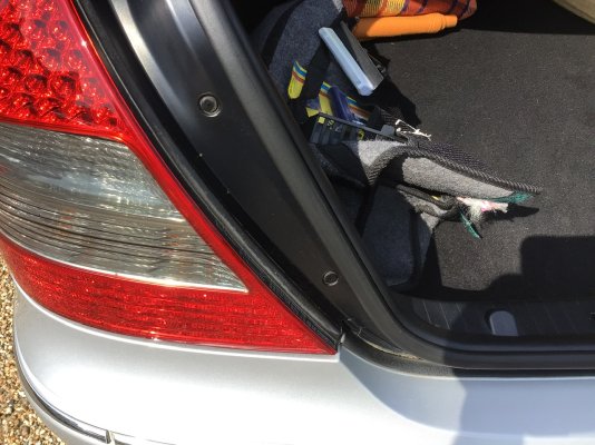

Bit the bullet the other day and rang MB Grangemouth (Parts dept) for some new rear boot drain/trim parts . Fearing that worst , I left Euan with the job of deciphering my email pictures as to which bits I needed .
He came back to me with the grand price delivered of £24 ish .

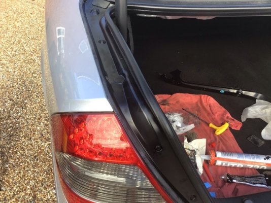

The parts arrived today , so I removed the manky broken and leaking old parts . I had already resealed the foam around the rear light clusters with sealant the other day .
I cleaned up the muck that was underneath and used sealant under the boot rubber that runs around the whole boot opening , before fitting the shiny new parts .
Finished just as the rain started.
Thanks MB Grangemouth parts dept for fast efficient and very well priced service , roll on the next failure

I used an rtv black sealant , I took the rear lights out and put a bead around the front and back of the foam seal . I also put some sealant where the trim push fit fixings go into the bodywork.
When the lights were back in place with their new sealant , I squeezed a big “wodge “ of sealant along the side of the foam seal where it meets the channel around the side of the boot . It seemed to me that if any water got under the trim it had a tendency to run down to the foam seal by the light fittings . This was an attempt to keep any water away from the lights/foam seal .
So far it’s all worked well , still dry

@W1ghty So, I've fitted these now too, but wanted to ask you if the lower part of the plastic trim where it reaches bottom of the boot and curves in are you plastic edges here underneath or on top of the boot rubber seal trim?
On top of the rubber seal at the bottom buddy
