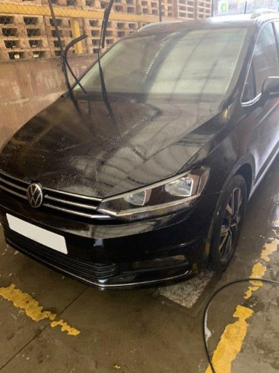

We picked up the new car a week before Christmas and I wanted to get some protection on it while it had the new car smell rather than wait for it to put in the miles and make life a little harder.
So we got the keys on the Friday and on the Saturday i got up bright and early and realised how bloody cold it was! I got everything set up then settled into a couple of coffees and checked through my emails while i waited for the sun to come out so i could get a good look at it and make a plan.
When it did i decided to give the car a good clean to begin with as the missus had to do some running around the night before and got it dirty :eek:
I started by apply 15% surfex HD through a pump sprayer gave it five minutes to dwell and then covered in BH auto foam at 4% PIR i went around a couple of times with the snow foam when it started to run off to freshen it up which gave it about a 20 minute dwell time. What i really wanted to achieve is to strip off anything the the Valeters may have used on the car if anything and see if i needed to do a pass with the machine polisher as i wanted the Wowo's Crystal Sealant i was applying to bond as well as possible.
Luckily for me the water behaviour showed they hadn't used anything to protect the car so i made the decision to skip the machine polishing step as it would have been only to remove any protection the dealer may have applied.
I followed up with the Multi Mitt method, rinsed with DI water and dried ready for the next step.
Now i wasn't as scared to touch the car though the dirt i felt the paintwork and decided to scrap using a soft clay on it too as the car had about 85 miles on it and i may have had to pull the polisher out if i did whatever i would gain i'd lose so decided it would have been counter productive, plus finish was already like a mirror.
The next step was chemical decontamination by applying fallout (BH Korrosol) and tar remover (Autosmart Tardis) which is why i dried the car i wanted maximum contact between the chemical i was applying and what it was designed to remove.
So i first applied fallout remover jet washed and dried then followed with tardis then jet washed and dried i gave the fallout remover about 10 mins and the tar remover a little over 5 mins, i was really sitting there (with coffee) eyeballing how much time each would need as it was only about 5 degrees out side which although i was freezing it was given the chemicals a little longer.IMG_6036.jpgIMG_6042.jpgIMG_6046.jpgIMG_6048.jpg
Was there any point to this step? Well yes, although the car had moved very far on it's tyres it had sat around and been transported so had plenty of time to attract contaminants. I couldn't if the fallout remover was turning red from the car or reacting when it was hitting the floor but settled on it was probably a bit of both and moved on by soaping the car over to and pressure washing again to make sure i got all the chemicals off especially the tar remover which is fantastic but nasty stuff.
Rinsed with warm DI water i had one more thing to deal with before apply the sealant which was a white glue like substance which looked like it had run out the door. I started with a 10% APC and a detailing brush but got it in the end with 20% and a microfibre scrubber, it was very glue like and only came off initially with my nail which is why i worked my way to something more aggressive.
After that i rinsed and dried areas ready for the Sealant which it got two coats of all over the car with an hour cure time in between more to ensure every inch was coated rather than an attempt to stack the coating, i returned the following day to add a second/third coat.

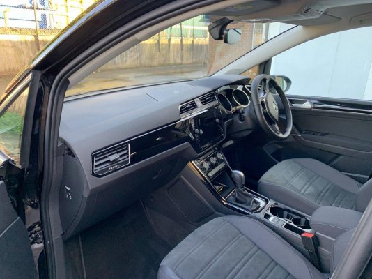

As you can imagine the interior needed very little doing to it out side of a detail brush and vacuum but i applied a couple coats of Aerospace 303 to the interior to help protect it and that was that she was ready for the world.IMG_6051.jpgIMG_6053.jpgIMG_6054.jpgIMG_6057.jpgIMG_6058.jpgIMG_6059.jpgIMG_6062.jpgIMG_6064.jpg
