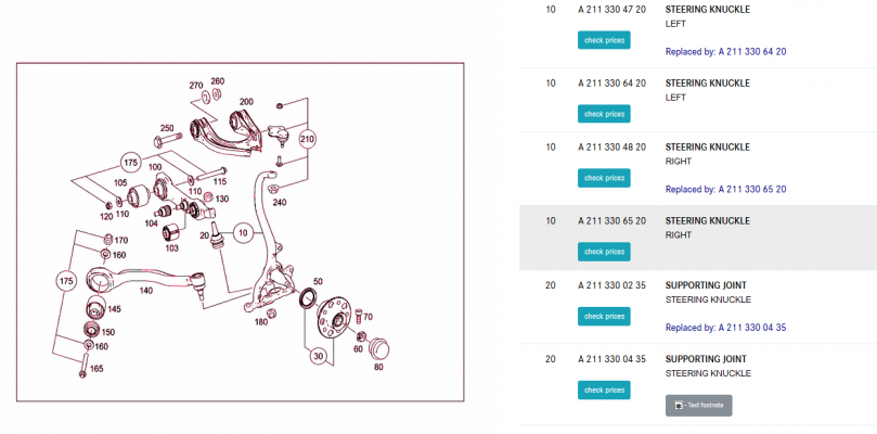

each side the lower ball joint, i had some shuddering etc when i got mine, at the mot they found that the lower; 20 (A 211 330 04 35 STEERING KNUCKLES) had worn and were just baning about in the sockets, also the upper; 210 ( A 000 330 10 07 RS TRANSVERSE CONTROL ARM JOINT TO STEERING KNUCKLE) needed replacing on both. well worth doing. I bought one of the big "G" clamp kits for doing the lower ones on ebay.
heres the ebay link:
here is a link to the online epc just put your car details in. Mercedes-Benz EPC. Car Mercedes-Benz CLS .
also here is a pic from there showing the suspension parts.
