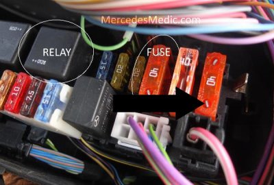

Easy way of opening the boot on an S-class when the battery is flat (I always found trying to use the blade a finger mangling job).
Open the bonnet, take the lid of the right hand fuse box (Drivers side in the UK).
See the front of the big two, or three fuses, usually 40 amp, or 50 amp?
There is a metal bit sticking out of the fuse, either side at the top.
Get a battery or a starter pack, or a pair of jump leads attached to another car.
Apply the negative to the ground point on or near the suspension turret.
Hold the positive to either one of those metal bits sticking out of the top of the fuse.
There should be enough power running through the system to open the boot.
I have used this method many times when I have been working on the car, and the battery has gone flat, had to do it yesterday because I have been swapping the A/C condensor, and the battery went flatunnamed.jpg.
Ignore the circles, its someone elses picture, the arrow is pointing to what I am on about.

I have shown you how to get into the boot the easy way, the drivers door can obviously be opened with the blade as Chris said, its easy to open the door with the blade, a lot harder to open the boot because it requires twisting and pressing, not an easy job, especially if you have a thick number plate trim, impossible with my car as it has a reversing camera in the same place as the key.
