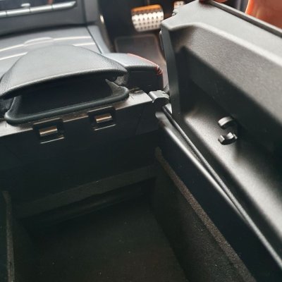

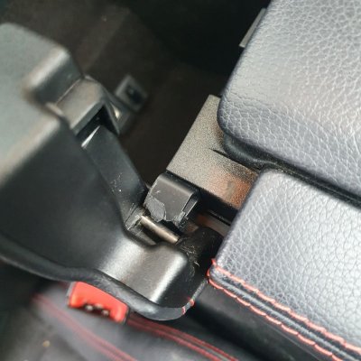

I will get to the point. I have purchased a 2014 E350 AMG Line 9G Coupe with 30K on the clock. The car drives very well but there are two niggles i would like to correct.
Centre Console
As you can see, a previous owner has broken the plastic hoop which retains the opening rod. Though this looks like it might be replaceable on its own, i doubt it is! Does anyone know what the most efficient part replacement is? I have found exploded parts diagrams which allege to be for the C307, but they aren't (one door is always longer, like the C-class).

Centre Console
View attachment 132222View attachment 132223
I hate waste, both money and parts, hence want to avoid purchasing a whole replacement module (PSB):
