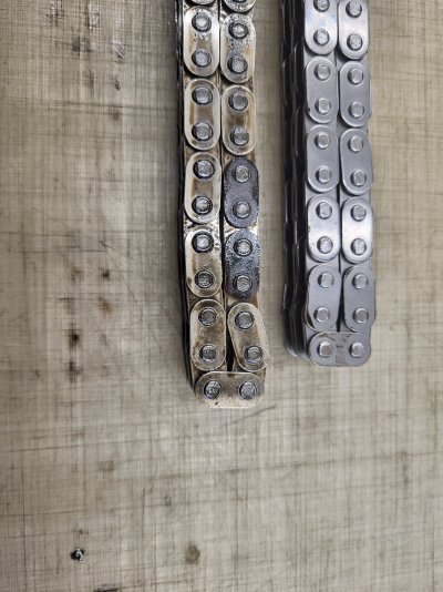

I guess that's true! It may not break but it can reach the point of jumping teeth. The tensioner extends until it doesn't do anything. That's where my chain was - rattle on cold startup and very loose when I pulled it out. My cams were 18 degrees out and fuel consumption averaged 19mpg, down from 23mpg
I think the sprinter service interval is too long at 19k even with 13L of oil in the sump. The soot particles in suspension cant be good for the chain. I'm going to change the oil at 8k from now on.
Replacing the chain isn't a quick job. You can break and join the new chain to the old and wind it through from the right side cam cover then rejoin it but I didn't trust that and had to take the engine out anyway to change the turbo, so I changed the guides too. The old guides weren't that worn to be honest.
See pic of old/new chain comparison
