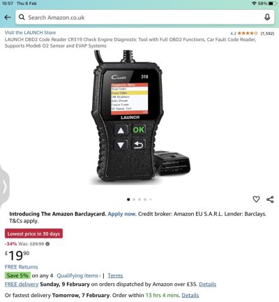

Funnily enough I was just reading that myself. I'm now trying to figure out what £25 OBD tool the person is on about as it almost sounds too good to be true but definitely worth a go.
@TC350 what OBD II tool do you use please?
It’s under £20 from Amazon at the moment.
Cheers @TC350 can I ask if that device can be used on diesel cars. The description doesn't mention anything but one of the pictures says not so I suspect it could be a different model for diesel.
I think it's probably only pre 1996 diesel cars that it can't work on. Perhaps they didn't use OBD2. But I've never owned a diesel car (or had any interest in them) so I can't be certain.

I just find it a heck of a lot easier to spend a few minutes every year plugging in my OBD2 reader to cancel the code (which you'd have to do anyway after cleaning!)
Cheers. That's definitely the preferred option. I've just ordered a scanner off Amazon so I'll give it a go tomorrow when it arrives.
If my experience is anything to go by, you'll just need to cancel the code 2 or 3 times over the coming month, then all will be fine for a year or so.
