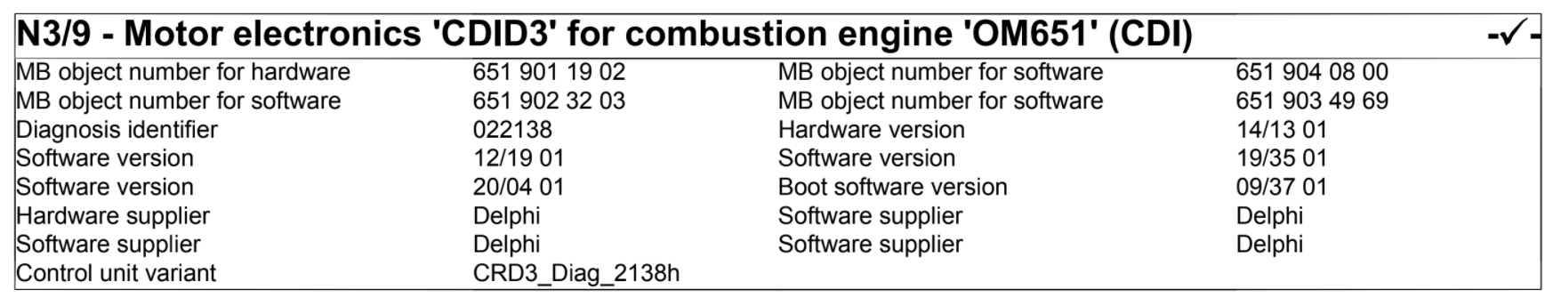

Mine (a 2015 E220d W212) is in at the moment with the engine light on. The recall was done just over 4 weeks ago and the engine light came on within 4 weeks although only 5 trips as the car has stood a lot during lockdown.
I only noticed the ECU, transmission (VGS) & SCR software versions change after the update.
The current error the car went in for as shown on an iCarsoft is a P229F / NOx Sensor Circuit Range / Performance Bank 1 Sensor 2.
I did read some people were getting line item 30o added to their data card after the recall which meant the correct new NOx sensors were supplied and fitted but my car still does not show this a month on (Two sides of the same coin)
Software versions from Xentry for reference (in case it ever helps anyone).
Pre the recall:
Post recall:
