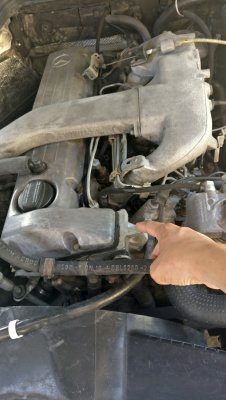

Jul 26, 2020 #1 Habil Active Member Joined Feb 3, 2020 Messages 146 Location London Car 1993 W124 E250TD I'm going to change the engine mounts on my OM602, is this the lifting point, where my finger is?
Jul 26, 2020 #2 John N MB Enthusiast SUPPORTER Joined Mar 22, 2017 Messages 5,965 Location Peterborough. - (Scot on Permanent Tour!) Car GLB 220D 4Matic P+ l would suggest that yes that is the Lifting Point, but to Replace the Engine Mounts you need to Lever the Engine Left and Right, not Lift it
Jul 26, 2020 #3 OP OP Habil Active Member Joined Feb 3, 2020 Messages 146 Location London Car 1993 W124 E250TD Lever the engine right and left how? According to Pelicanparts you can do it with a engine lift. You see my sump is got a crack.

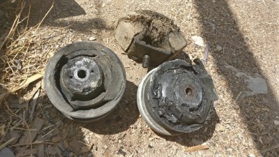

Jul 27, 2020 #4 OP OP Habil Active Member Joined Feb 3, 2020 Messages 146 Location London Car 1993 W124 E250TD I have changed the engine mounts this morning they were knackered, I used the lifting point to do the left mount and for the right I used the lifting point and also the engine mount arm. Here are the old mounts,I did the transmission also.
