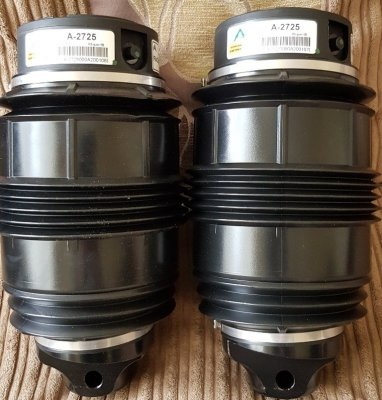

Anybody who has purchased Arnott know if there is any branding on them to prove they are indeed Arnott? Mine have arrived, but no branding and no paperwork, install instructions etc. saying Arnott. Cheers!
Mine came in Arnott boxes with instructions and new air fittings in an A4 plastic bag.
