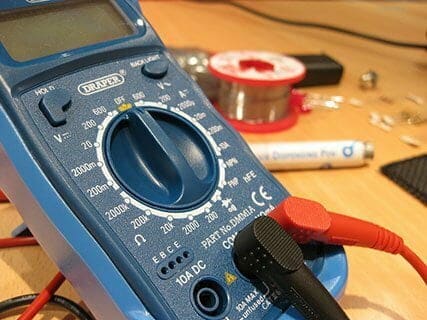

You can also test with a multimeter though I have never used that method
cheers for that Andy - very much appreciated - I'm gonna get my avo out!
