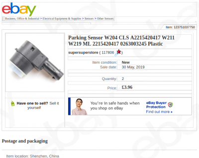

I ordered a bag of the A2215420417 parking sensors from China. For our 2010 ML350 CDi (W164). £4 each inc. shipping from a Shenzhen ebay seller. Imagine my amazement when what arrived were genuine Bosch sensors!
Definitely a DIY job replacing them; the Merc garage demanded £520 to remove (rear) bumper, replace two sensors and re-fit!
