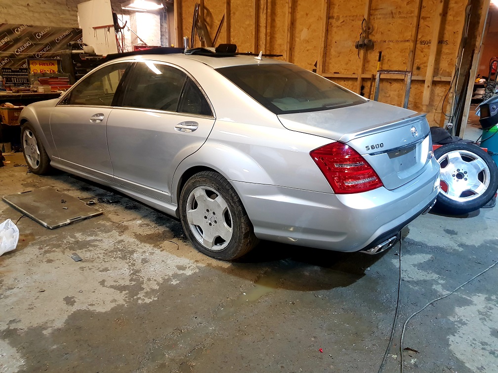

The car was then dropped off at the bodyshop and they took their time but I didn't mind. A month later the car was ready. It had both sides resprayed to get rid of any imperfections plus the AMG kit with the rest of the other facelift parts that needed spraying.

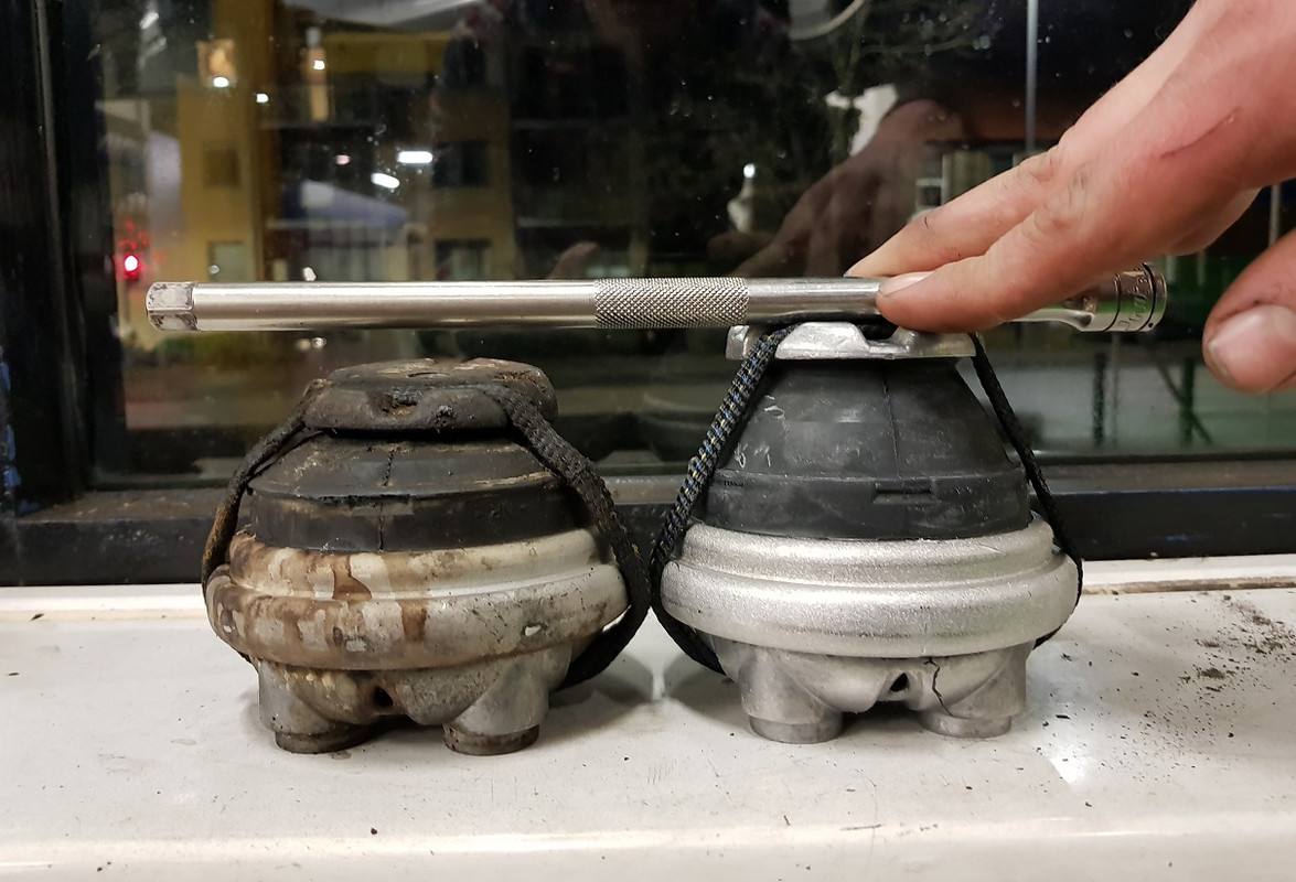

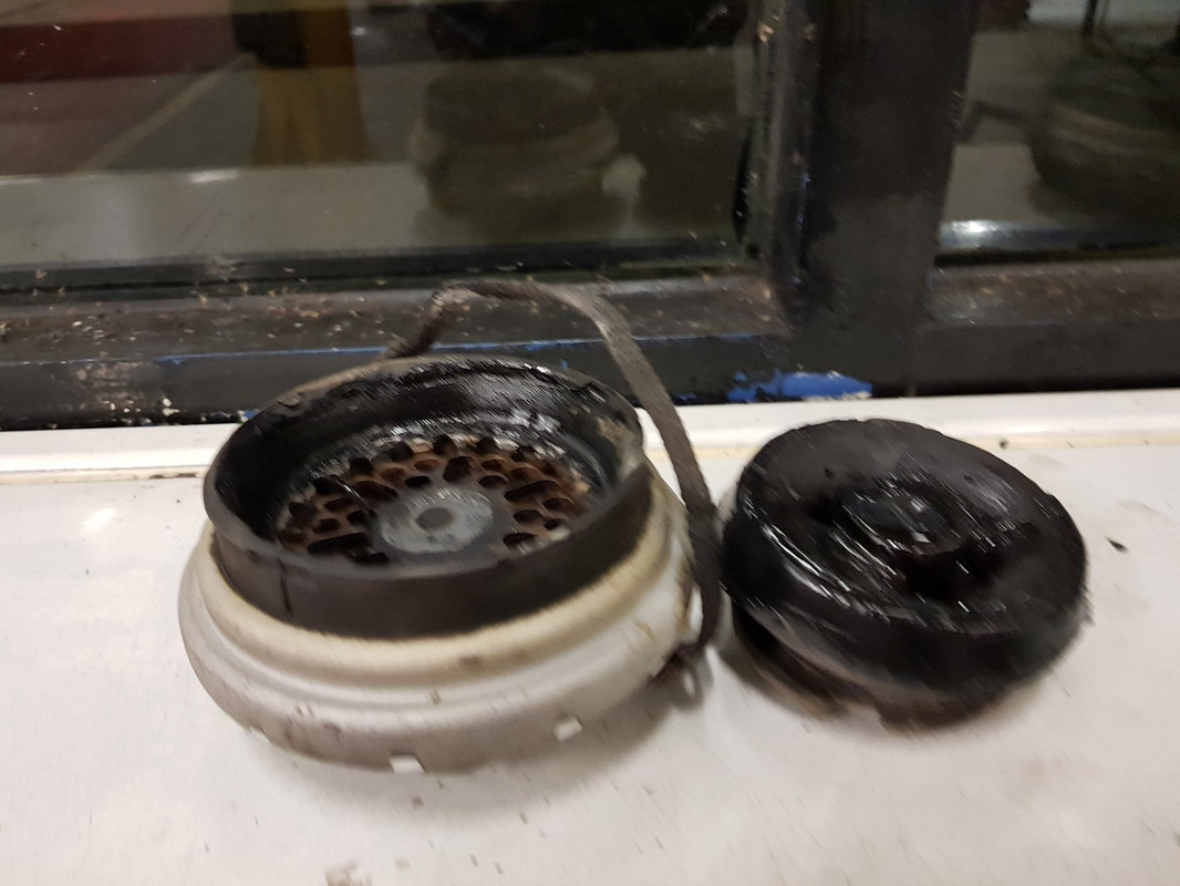

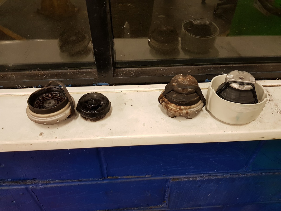

I changed both engine mounts
Gearbox mount too.
Engine mounts were completely gone, one side was split in half when I took it off.

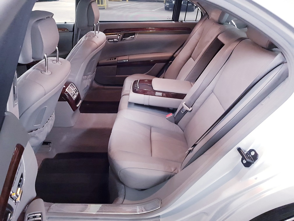

The interior was in good condition or so I thought it was but once I started cleaning it, I realised how dirty it was! You'll see for yourself, but now it looks fresh ( i think )

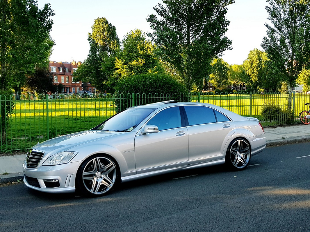

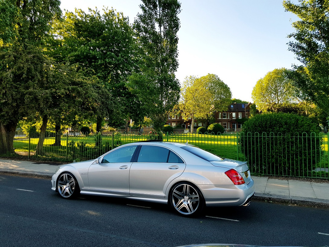

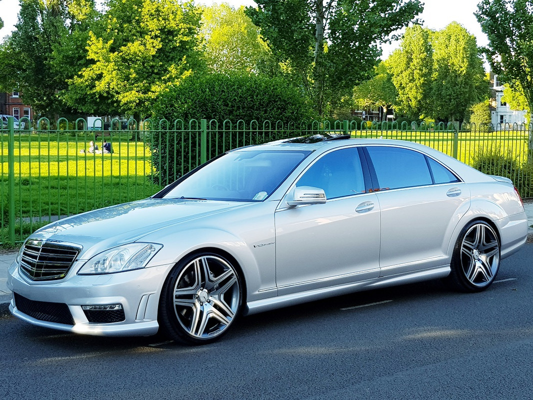

Anyways here's the car, some before and after pics
I like how all windows including the front windscreen and rear window have this green, blue, purple look in different angles
Parked next to my m3

Gearbox mount
Gearbox mount too.

Gearbox mount
