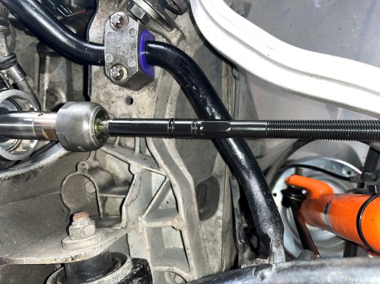

If you have had a new rack fitted it would also have new inner tie bars fitted (they are cheap) I have just replaced mine , installed new gaiters (all Lemforder) , the rack was fine but I removed all of the grease that I could get to and replaced it = super smooth. It should look something like mine shown here.
Who supplied the rack ?
I thought a new rack would heve come fitted with new tie rods any way
My point exactly . The new rack would have been complete with inner tie rods and gaiters , a pretty straightforward job for any mechanic hence me asking OP where the rack came from.
