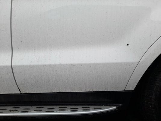

The Rear passenger door was treated with 10/1 detail driven Citrus and covered in BH AF at 4% with No prior rinse
Left to dwell for 5 mins then fully rinsed
Hopefully you can see from the pics that all the panels are almost completely clean.. treated in 3 different ways but still having pretty much the same results without any contact wash.

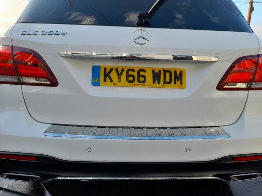

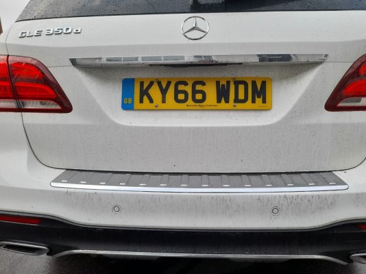

Now the Boot. This was treated with BH Auto Foam at 2%PIR mixed with 25% Surfex HD with No prior Rinse
Then left to dwell for 5 Mins then rinsed away

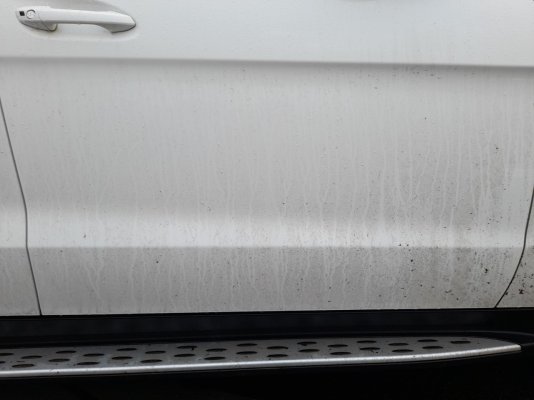

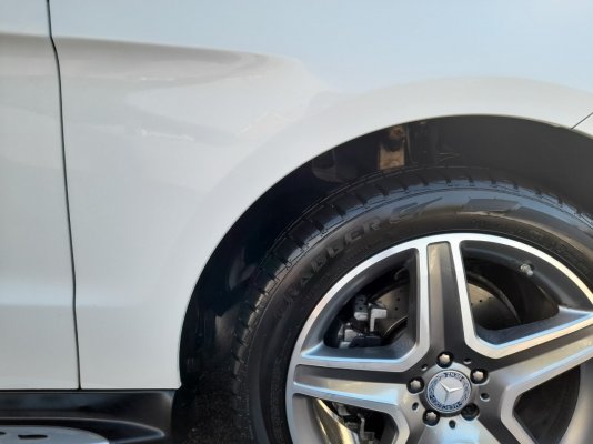

So Now I did the entire Drivers side with BH AF at 2%PIR mIxed with 25% Detail Driven Citrus APC.
Again the same process as the other side, no prior rinse.
allowed to dwell for 5mins then fully rinsed

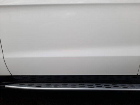

Drivers door and rear door applied with the same as above,

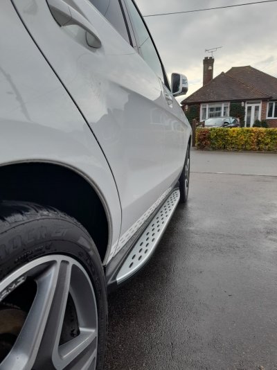

Both sides and rear now fully rinsed and dried with a Blower
So far after todays testing.. I can't see a visible difference between BH AF at 4% compared to the others treated with Citrus or Surfex HD and then covered in BH AF.
ON the drivers side and Boot there is a very small amount of Soiling left, but only visible when looked at very close up.
the panels that were mixed with Surfex HD left some product residue that was only noticeable when rinsing off.
Overall I think that Just treating with BH AF at 4% and rinsed would have been sufficient as I can't see any visible difference. So again this confirms for me that foaming prior to treating with any APC or Citrus would be enough in most cases, Unless the soiling had been allowed to sit on the panel for a long time.
