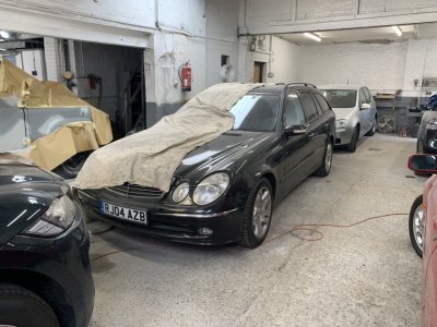

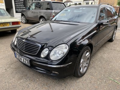

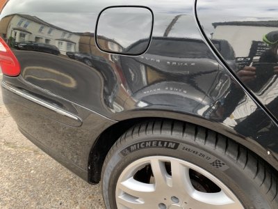

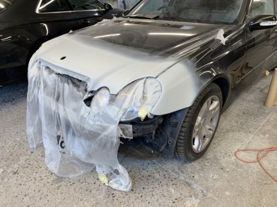

I popped into the bodyshop today to check on progress
817A87FD-FEA5-493C-A588-4E7B5B8F2B04.jpegAC1C1DAD-01D9-43D8-90C5-6125E47A6BE2.jpegF428F434-50D8-4C50-85C8-9EF10E5C2036.jpeg5367298B-F8E3-4E4D-9C96-009113EFBF25.jpeg

Always exciting to get fresh paint, are you getting them to flatten the whole car free from orange peel?
When you are ready to wash & polish it etc. Get some Poorboys black hole polish, and protect it with Poorboys Natty`s Black paste wax, itll look sick..!!
I haven't considered that Sicario, though tbh I haven't noticed an overt orange peel effect.
I'd be interested in Poorboys, why do you recommend this. in particular? I still have my Bilt Hamber range of products to work through and a DA to experiment with...
Apparently poorboys is the law with black paint.
And yeah i noticed you have a lot of orange peel, Mercedes factory finish is very peelie, you get a mirror finish in black by having the orange peel flattened, its scary how different the two finishes are, you tube it and you`ll see.
Just a few days ago i was looking over my nieces 2019 C220 in black, soooooooo much orange peel all over
I see what you mean actually. I'll get a running estimate and then ask them for a cost.
Can I not remove orange peel myself with a DA or it is a job for a pro with a rotary?
Wet sanding my friend, you cant polish out orange peel, what i have discovered is that its 10 times easier to buff out sanding scratches than it is to actually polish out a scratch or swirling/spider-webbing
