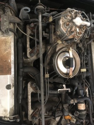

Hi guys,
Would really appreciate a steer here.
1990 R129 500SL parked up for 2 years. Started a week ago but it was in a small garage and because of fumes it was only run for a few seconds. With hindsight maybe not the smartest…
Won’t start now, just turns over. Battery very strong, immobiliser believed to be ok. Fuel tank drained, new plugs. Nothing.
Getting fuel to the Bosch distributor ok, getting pressure out (x7, one was awkward to reach) of the distributor. Dried plugs, nothing.
How much (old?) fuel sits between the distributor and injectors? Lines look very narrow, can’t be that much...
Forums point to Mass airflow sensor (not sure these early cars have them?) or Crankshaft position sensor? Is the second stage of the fuel relay not happy with something? Are there sensors which don't allow it to stay running versus don't allow it to start running? Fuel and spark and no fire a little odd…but perhaps its a sensor somewhere..
Any assistance greatly appreciated.
Thank you
GCMAN50

Hi Graeme, thanks for attaching. Gone through the adjacent thread. Any of the 'worth checking' suggestions have already been covered and slightly different in that it is not starting. It is getting spark and good fuel pressure but no detonation. My mechanic has never seen the likes before:
1) Tank drained, fresh fuel
2) Fuel pump working (stage 1). Stage 2 is only when engine starts so I don't believe to matter.
3) Spark plugs changes - several times
4) Disty caps cleaned
5) Camshaft & Crankshaft position sensors have resistance.
6) All fuses good, inc OVP good.
Getting fuel into Fuel Distributor. Good pressure x 8 out of it.
Car started a week ago.
Not using OEM alarm, Toad unit fitted.
Late 1990 car - non CAT.
Has a 9 pin round and 16 pin (of which 8 are in use) - what appear to be diagnostic terminals.
From my research the 9 pin gives limited value when engine can't be started. It checks CPS which we know to be sound.
Tried WD40 in bores and air drying, (bores look bone dry). Turns over but no bite..

Forgot to mention - cold start ok too
Check the engine earth strap and its connections- high resistance may lead to significant voltage drop on the engine electrics when turning over.
Right, problem sorted - glad to say. Thank you all for support.
A specialist MB dealer diagnosed as a faulty component in the immobiliser. It was getting fuel and spark but not the required pulse signals to run. He has bypassed and starts first time every time. Happy days !
