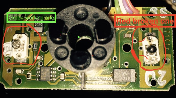

For quite a few years my red LED has not worked on the rear view mirror (part of the IR sensor that sits underneath it)
I have taken it apart and the led bulb holder looks pretty damaged
I have thought about soldering the wires straight onto the board but decided against it as i think i would make things worse (Jethro Bronner on youtube introduced me to this german word Verschlimmbesserung which applies to me in this case) and like to get it professionally repaired, does anyone know of anyone who can do this?

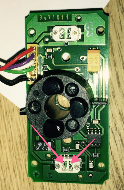

I did purchase a mirror from a W210 eons ago and this board
a) works perfectly fine in my car
b) has non damaged bulb holders and
c) did not come with LED's :-(
but I purchased some 12V bulbs
And tried to fit them but failed miserably, i think the way it is supposed to work is to cut the wires from the bulbs to a shorter length and then by magic you push them into the fitting and if you are a wizard or very experienced at it the tiny little wires at the bottom of the holder which you can barely see (see pink arrows) should touch the wires of the bulb and he presto it works, i have tried this dozens of times but have had no joy
All this work just to get the RED led to work, it has been on my todo list for years and years and like to figure this one out :-)
I soldered the led onto the w210 board and both lights work. Green when unlocking and red when locking (and red led does not flash when alarm is on)
I bit the bullet and soldered the led light onto the original r129 board and it works too. Result. however the red led keeps flashing. Just like the door led flashes red. At exactly the same time.
is this expected behaviour? I know the door led is supposed to l flash red every 5 seconds or so but the red mirror led has never worked for me.
any r129 owners who can confirm ?

Anyway all working perfectly now. Red led flashes when you lock the car and it blinks at the same time as the door led.
