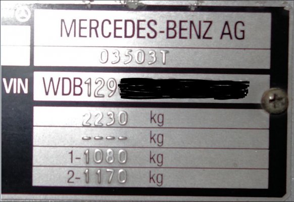

As your car was registered after 1st August 1998 it must have type-approval in order to fit a towbar ... it's illegal otherwise. You need to check the data plate on the car to confirm there's a "maximum gross train weight" given ... this is normally the second one down. If this is blank or zero (as it is for my R129 SL500, below) then unfortunately you can't tow. My VIN plate:
The handbook is a general one and not UK-specific. It's the data plate that the Police will go by if you get stopped.
View attachment 112804Good news folks,. Thanks everybody for all the help. Tony
Show that to the fitters, it will help.
Over the years I have retrofitted towbars to several cars which are thought not to be type approved for towing. Showing the equivalent photograph helps.

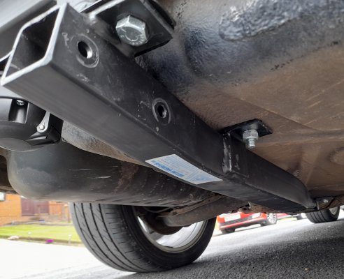

It came yesterday from SLSHOP, originally supplied by WATLING of St Albans, very German. Left a message for there parts dept this morning, no tow ball and no electrics as advertised. Its a bumper off job to accommodate and drill for the cross member and then bolt another arm to that and to the axle support after drilling, and then two more bolts through the spare well. To detach it you undo two bolts and slide the box section out with the tow ball attached. All you will see is a small box section right underneath set back under the bumper. Good clear instructions came with it with all the bolt sizes and torque settings. Better weather next weekend for fitting and pickies to follow. Stay tuned.
Well its on, just the electrics to do tomorrow. Not quite hidden as i hoped-for but its not a big job to take it all out when i have finished moving stuff to France, whenever that will be lol.
Got any pics with trailer attached from the side view? ground clearance seems a bit minimal.
Tony.
Not got one as yet, looking for something around 5 x 3, an extra boot for the wifes shoes and bags lol. Will post some when i get one. The clearance in about an inch lower than the back box and tapers away at the axle so not to bad.
While you are on the subject of electrics Tone , just keep an eye on the cable that feeds the trailer at the plug socket, it might just be the camera angle but once plugged in the cable might be getting close to the road surface . 👍
You are dead right, i think i will bend the socket 90deg so the plug will be horizontal, theres plenty of space. Well spotted and thanks Pete
