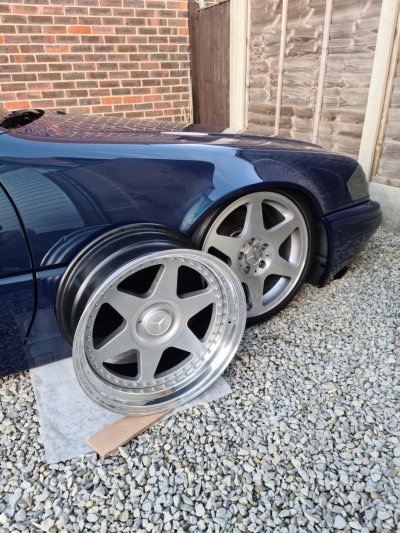

Custom made 1/1 16" evo 2 centres then built to a 18" wheel. 2.5 front lip and 3.5 rear lip. These are the original evo wheels chopped up they are a complete new machines centre by tt_polish in Germany

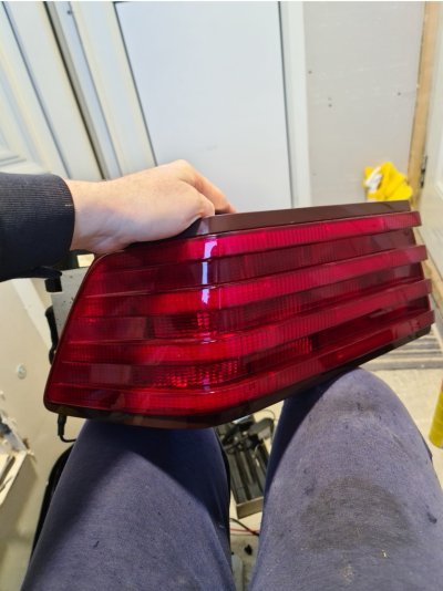

I have also stripped the rear lights and converted the side light to led and tint sprayed red. I wanted to give it a futuristic look at night and suit perfectly imo

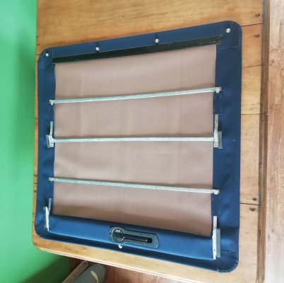

I found a hardtop in a skip and decided I need to do something special with it. As we all know the hardtop is a heavy to remove and need somewhere to store. So i Managed to source a mgb britax openair roof. Then proceed to fully strip it and rebuild it, sent it to a trimmer who remade the fabric top in original mercedes blue fabric mohair to mate the soft top roof
