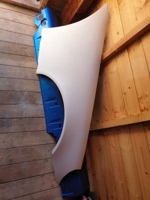

I have made cardboard templates for the bracket and wing lip and made my own and welded the newly fabricated bottom lip to the front wing and cut out another patch of rust in the bottom of the wing and welded new steel in it and made a bracket using 3 pieces of mild steel bent as close to original shape as possible with hammer and block of wood and am currently skim fillering and sanding the wing now ready for primer. I had nothing to start with but cost of cheap welder and small sheet of mild steel along with filler and sand paper cost less than one new wing and I need to do both fronts so it works out cheaper this way for me. Painting will be the interesting part as my paint code says 372 but my metallic paint looks slightly darker than the test paints I've seen online and car has got over spray from a previous spray job in its past life. Could end up with different shades of blue haha. Stopped the lockdown blues though so it's all good.

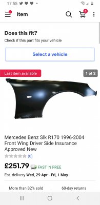

Ebay have new wings for earlier version pre2000 facelift, but still need to blank off the side repeater hole and fettle it too fit as with all patent parts.

And as far as I can see, you cannot buy the inner bracket anywhere. And all scrapyards I called had them on the car but they were rusted out like mine so it has to be made from scratch. I still need to buy 2 nuts and bolts and weld the nuts to the bracket I have done a flat bottom on the bracket and will pass the bolt for the wing through the bumper aswell, slight mod from original spec but it was easier.

I have now welded the new lip to the bottom of the wing, skim filled, sanded and primed and flatted the primer, now needs colour coat and clear coat then I can knock that off the list that needs doing.

You could just repair it yourself, I've just cut the rust out, welded in new metal, made a new inner bracket, repaired and resprayed one wing on my SLK320 for the price of a professional to do it, and I still have all the stuff now to do the rest of the car where rust is bubbling except for paint and clear coat. So now future repairs will cost the price of paint and lacquer and some of my time. Much cheaper in the end. IMG-20200528-WA0001.jpg
