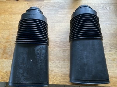

Got mine, 9 days from HK and £50 for a pair

They look exactly like mine which finally arrived Friday. Have you had yours fitted yet and we’re there any problems? I’m taking mine to my specialist tomorrow.

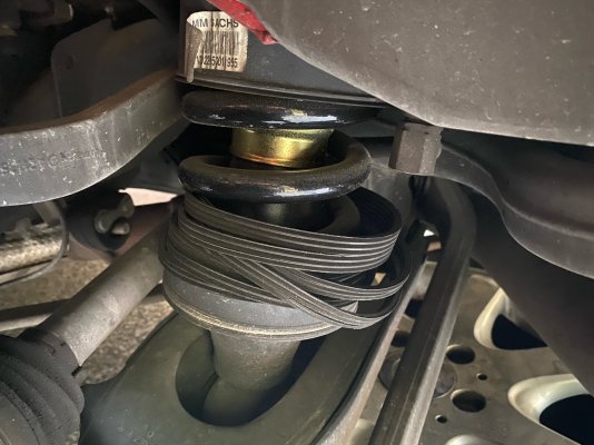

Can't look worse than this… Crap OE is right, Granted this is 20 yr old plastic/rubber but this is a car w 34k mi, always garaged, in a (pre-dominantly) warm/hot climate and rarely, if ever, sees rain. Looks like a serpentine belt job gone wrong :

Indeed. It’s disgusting that such poor quality items were used to protect such an expensive component.

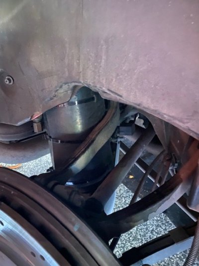

Just to follow up…

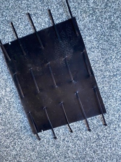

Finally installed my homemade dust covers—i ended up cutting slits into the sleeve to hold the zip ties in place. For the fronts i did use 3M weatherstrip adhesive (after cleaning the sleeve and the strut housing) along the top edge and cinched the zip tie as tight as possible to keep it affixed to the strut body. For the remainder, i tightened them snug but not over tight to allow the strut to move up and down as needed. Plenty of room to work on the fronts, not so much for the rears so i skipped the adhesive, just cinching the top tie as much as possible. Also had to shorten them since you can't really access the top of the struts.
Each sleeve has about an 1 1/2" of lateral overlap. Even if it's not 100% it should keep most of any dust or debris out. Definitely better than ripped covers.
Total cost was $60 for a huge roll of rubber sheet and $10 for 24" zip ties.

Well done. Good idea with the zip ties. And yes, the rears are awkward but doable. Anyway much better than crap new and expensive MB covers.
