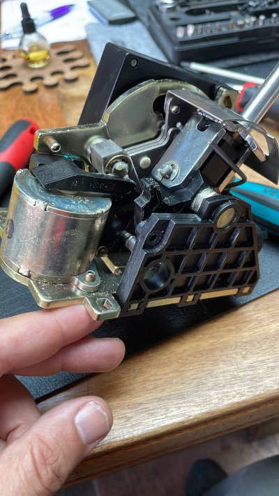

Hello,
My wife’s 2004 SL350 is stuck in park, searching the forums leads me to believe it’s the little plastic lever that is operated by the solenoid. I see there’s an ally alternative too…. What I haven’t been able to find, is how to get it out of park to enable the unit to be removed and the broken lever replaced.
Please tell me I can sort this on my drive!!

This may help get it out of Park. The method is just the same for an SL.
Hi,
Thanks AMGeed - I had seen similar videos but none of them gave me the confidence that it would be ok for the SL! It would’ve been just my luck that it works on every model but the SL😅
I shall keep you all posted

Got the car out of park!
Have the selector box out…….
The plastic lever is not broken - it appears the solenoid is the problem.
It energises and moves the lever about half the distance it needs to, if I touch it slightly it moves all the way.
Can I get a new solenoid?…..

Will this method work if the car has now electrical power i.e., the battery is flat?
That's a mechanical solution to a mechanical problem. Try connecting a charged battery first and see if the problem goes away.
