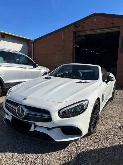

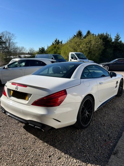

Hi everyone.
I went to see a SL63 this week, and performed a HPI check after leaving a deposit where the following mileage discrepancy was found.
MOT performed at 18,718 miles on 20/06/2023, then the mileage increased to 27,527 (Recorded by VOSA on 02/11/2023) before dropping down to 20,682 miles at the next MOT on 28/05/2024. Not good...
It should also be noted, the private plate on the car was registered on 24/07/2022 and then removed on 18/11/2023 (presumably when it was then last sold).
My concern would be, if this recording isn't a mistake - the owner in this period has clocked it and unwound the mileage prior to it being moved on late in November 2023. So what's recorded as a 21k car, could be anything...
What I also wonder is what led to the recording by VOSA/DVSA on 02/11/2023 as it was between MOT's?
More bizarrely, Autotrader's own HPI check showed the car as clean. I have a friend in the motor trade and got him to check it - clean also. However this discrepancy came up for me when checking it on hpicheck.com
I have had my deposit returned, and left it to the dealer (who was very apologetic and seemingly surprised) to see if they can correct this on national mileage database (they are sure it must be an error). The car did look very clean, still with 2021 dated MO tyres on with lots of life. However, for me to even consider buying this car if the mileage is corrected and was an error, for peace of mind I would want it inspected by a third party star dealership. Question is....what is possible to check - does anyone know?
