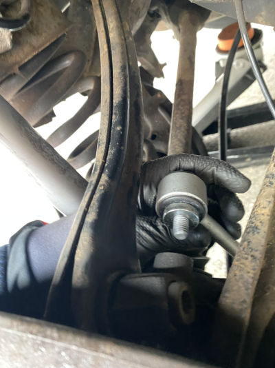

Few weeks back I fitted a drop link to the rear passenger with no issue.
When I tried to fit the rear driver, it would not go in and the bolt would not "catch" when put through the drop link - so I thought maybe the part was damaged or defective so bought a new one. Same story.
The part looks identical to the original genuine one, however it will not go in at all. The original part goes in and out fine.
Any ideas ? Car is a 2002 C240.
All I can think is that the aftermarket parts are no good and I need to go genuine.
thanks

Yep both wheels off the ground, safely supported by axle stands.
It would appear that the aftermarket part is holding the bolt at ever such a slightly wrong angle, meaning the bolt will not catch into the subframe ( as I tried to show in the photo above )
they are F.A.G parts, so decent quality.
