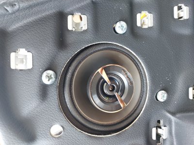

The lower section needs to be removed new speaker lines up with 2 holes so need to drill hole in panel for 3rd screw as not secure with just 2. (you can't see the hole as its covered by the middle panel.

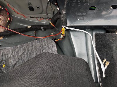

Whilst I was in there I taped into existing wires and made connection with extra wires into the boot if I want to add sub and amp I now have signal wires from the existing rear speaker wires. retained original plug added new wires (white) and ones into boot (red and black).
Factory speakers have rubber fittings which push into panel to secure, new speakers don't so had to nut and bolt them in M6 nut nut and bolt.
