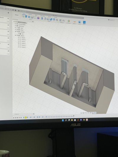

Not wanting to go through the faf of sourcing another RVM and having the same issue, I called upon the help of a friend and his 3D printer.
We started off taking some measurements and pictures of the clip, put it into the design software and doing a test print.
We then test fitted and made adjustments where required until we got it spot on. This was the final result of that part. 5C9A4331-5957-42CF-B993-DF8D5E877C56.jpeg9DE556BD-2D29-45A0-A2EA-FBE66DD48A55.jpeg
From there we took a bunch of other measurements such as the distance between the clips on the DRVM and width of them, we estimated the angle of the windscreen and started to design the rest of the mounting plate. We then set the printer off to print a prototype. Again, once this was done, we fitted it in the van, looked at any adjustments that needed doing and made these on the PC.
