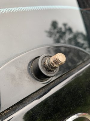

I've decided to remove the arm and lubricate it.

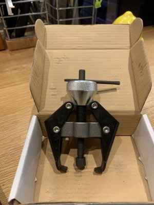

However, removing the arm is proving more difficult. A friend has recommended a tool.
Cheap wiper/battery terminal pullers are widely available. Do not be tempted to hit it or lever it . Windscreens and wiper motors are expensive !
Okay, arrived earlier than expected from Amazon, though I'm likely to have to wait until the weekend.

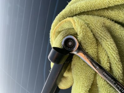

I'll admit that there was a tiny bit of head scratching before the penny dropped. Once I had figured it out, the tool works very well indeed.
I couldn't see anywhere obvious to lubricate, so I refitted. Incidentally, it's a 13" spanner for the bolt to secure the wiper arm.
It is working, however, despite all of these shenanigans. The method of 'manual intervention' has had the effect of freeing up the stroke of the arm. Ho hum.
13" spanner? That must be one hell of a nut! :D
