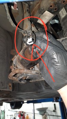

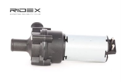

Quick one before I return the item. I bought the following Vemo pump online but the connector is different.
It seems like all the sites match on this same pump for my car- am I missing something, or do I need to pay 3 times as much for the OE part.

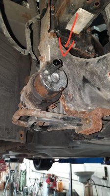

In the latter photos you will see the connectors on the currently (leaking) installed one in car.
Please ignore Ridex logo on image. It's the same connector type:
(Or perhaps it's a crimp + heat shrink job?)
Crazyl, I can't find the pump with my fitting anywhere, online.
Closest the "looks the same" is the SL 600 from the same era. What is it with this part matching business? Why is this wrong?

Looks like the pump is right .But wrong conecter on the loom . There must be a change along the line .Take a picture of the male conector on the pump that fits in to the female one in your hand .Take the pump off and show more of it in a picture .

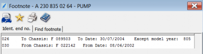

Great responses so far, thanks. My bad, I keep forgetting to post the VIN, which is WDB2304752F073571.
I got the part number from EPC/WIS software that I installed from the web.
According to my EPC diagram/listing I get that part number with no mention of succession.
Also, it has the following notes:
Any ideas?
Thanks in advance.
With your VIN it lists only A2308350264 as the correct part. There is an 03 part but does not show with your VIN.
