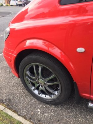

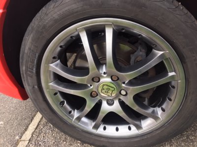

Thanks to all those that replied. Thought it would be rude to ask for help and then not reply with the outcome. I got them powder coated in a shadow chrome finish in the end. The cosmetic bolts are out and I'll debate about putting them back in again at some point although you can only notice theyre missing if you're right up close looking directly into the hole. Here's a couple of pics anyway.7450CFD3-EEB5-410F-A92E-724F9100C34F.JPG B07D16D5-99AD-4808-AF7D-34929F74E943.JPG
Thanks to all those that replied. Thought it would be rude to ask for help and then not reply with the outcome. I got them powder coated in a shadow chrome finish in the end. The cosmetic bolts are out and I'll debate about putting them back in again at some point although you can only notice theyre missing if you're right up close looking directly into the hole. Here's a couple of pics anyway.View attachment 86171 View attachment 86172
