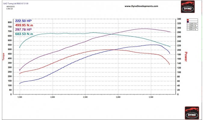

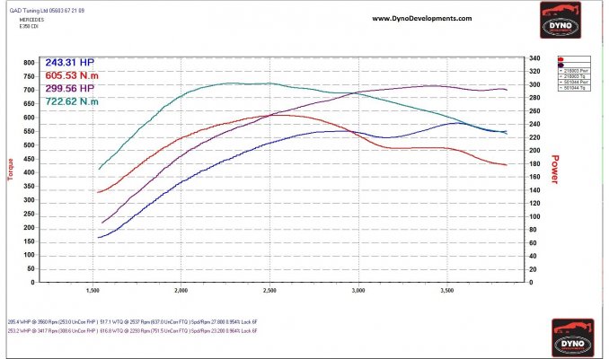

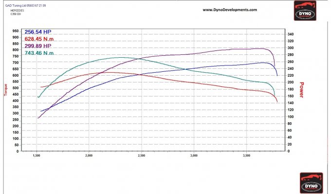

Here's a similar thread I created: Wildly different figures/claims when remapping an E350 CDI | Performance Lounge
I've found that some places places actually quote way less than they can actually make (except for GAD!). MSL for example quote the minimum gains, rather than the maximum. They end up getting results which are just a bit lower than GAD, for an E350 at least. Maybe it's something to do with not wanting to over promise and then have angry customers, etc.
It's the 'off the shelf' maps and tuning box companies that seem to over promise, IMHO

My CLS 350, with an MSL remap, makes a bit more power than all four and a bit less torque than three of the examples in post #9. It could be down to small variations in the engine, or small variations in the dyno, or small variations in the tune. I've had the same engine in a 2014 with a tuning box on it, and it was a little disappointing; the remap feels much better, and faster, than the box.
Some of the more exaggerated claims from some tuners are likely either straight lies, or using 18% rather than the more conservative 14% for the correction factor.
