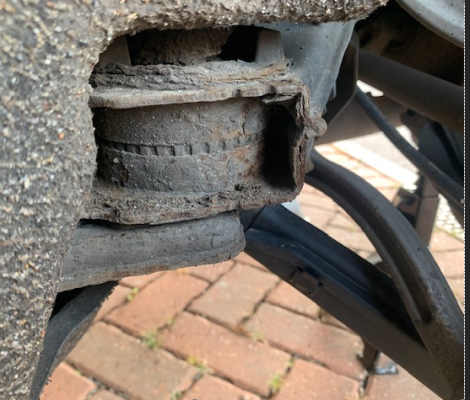

Whilst I was under there I took some pics of the bushes and suspension parts - can anyone advise what needs changing as it all looks a bit worse for wear under there:
1724792992118.png1724793003040.png1724793031794.png1724793060313.png1724793089923.png1724793109307.png1724793128285.png1724793146175.png
I got a pick in the rear sub frame and lots of flakey corroded metal came out - It was OK at last service.
Is there anything obvious that stands out? The car drives well with no creaks squeaks etc. Thanks

That is just light surface corrosion. If you don't have the right equipment you will struggle to replace them. They can be buggers to get out.
Thanks - That's not a job for me - I wonder if they would be replaced in the event of the subframe being done? Any indication on the labour hours to remove and total cost to replace?
