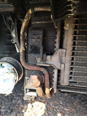

I have a 2009 CLS Grand Edition (C219). It has been a great car with only 93,000 miles on the clock.
With no employment and plenty of isolation time I decided to (successfully) diagnose a bi-xenon that had gone out. Having removed the bumper i noticed a great deal of salt corrosion on the frame which is getting a dose of black hammerite spray paint. More worryngly, the metal cooling lines are heavily corroded (pic attached). This model has lines to the water radiator and an oil cooler clipped to the front of the A/C condenser. At the other end of the metal lines are nuts connecting the metal lines to rubber hoses which are accessible as I have lifted out the water radiator fan.
I have got new merc parts and I'm ready to switch out the lines. My question is; when i undo the nuts at the rubber hoses will a significant amount of transmission oil flow out? How much can the transmission lose without doing damage? Is it ok to lose whatever comes out of the pipes or do i need to somehow pour that back into the pipes?
The car to-date has full merc service history and the last one indy. The oil has been changed (an option) once at a previous service.
(i will be swapping out the A/C condenser out as well since it has a leak)
thanks for all responses, Dinyar
