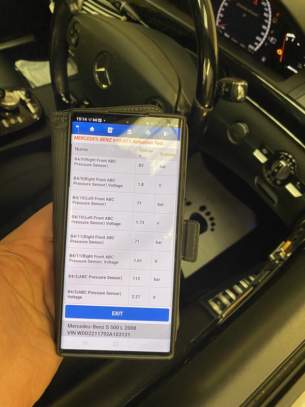

Hi again,
This were the readings I was getting. I have no idea if they’re good or bad so I thought I’d take some pics and post them here for the ones that understand :) The ABC pressure would change as it was giving live readings, it was going higher, starting from around 160 bar to 190 bar or a bit more. Does this mean the pump is healthy?
I thought I’d try and release any pressure that might be in the system. I done that a few times. Car would go right down and then go up and down a couple of times and then it would go up to its normal height once the procedure was completed.
I also done the rodeo test a few times.

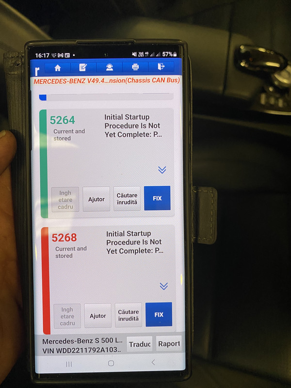

Then I thought I’d do the level calibration but once I would press F3 on the computer to start the process, it wouldn’t work. Then I thought I’d leave it alone but when checking for fault codes after not being able to complete this, the faults below came up and I wasn’t able to clear them.
Not sure if I messed anything up?
This were the fault codes because I couldn’t compete the levelling calibration.

Now my question is, do I leave it as it is? It seems to drive normal, no warning lights and suspension is staying normal but why can’t I clear this codes?
My friend said he will bring his star computer next week and we’ll plug it again and see if we can clear them with the star system
Thank you again for the advise @alexanderfoti and @BlackC55
You need to do the level calibration before clearing and go through the initial start up procedure. Until you do that the codes will not go.
