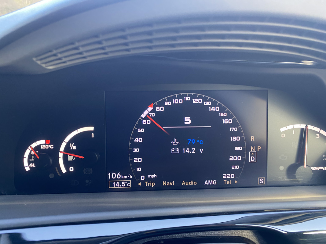

Just thought I’d update this thread
I have a friend with a CL63AMG ( prefacelift ) and I asked him to give my his cruise control unit that sits behind the grill as I thought that would have been the problem with my car.
Two mins job to take mine off and plug his one in. The last four numbers were different from mine but I thought it was worth a try.
As I joined the motorway today, I put the cruise control on and it works perfect!
My car has radar cruise control and all the functions work as they should, closing the gap between me and the car in front or increasing the gap.
I thought it was worth mentioning this in case someone else has the same issue and thinks it needs coding or something like that. It’s just plug and play as long as it’s the same looking unit and has the same plug.
No coding, but you do need to calibrate the aim. If you find it slamming on the brakes when you go past lorries on the inside lane.
