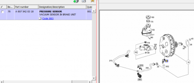

Does anyone know how to replace this?
It's the pressure sensor on the brake servo booster, I'm getting a code for it. I think it's the reason my stop start doesn't work.
Local mb dealer is having some difficulty getting the part... The mb system cancelled his order?!
A0075420318 is the part number
Ah, no, I think it's only for the stop start system, I.e. Cars without stop start don't have it.
I guess if vacuum drops then the engine is restarted.
Certainly didn't notice any adverse braking when mine went .
Theres no dire warnings on the dash, which I would expect if its safety related.
I only found the code scanning using an icarsoft, and it clicked about the start storp when I looked it up on the parts diagram - code b03 means start stop system.
