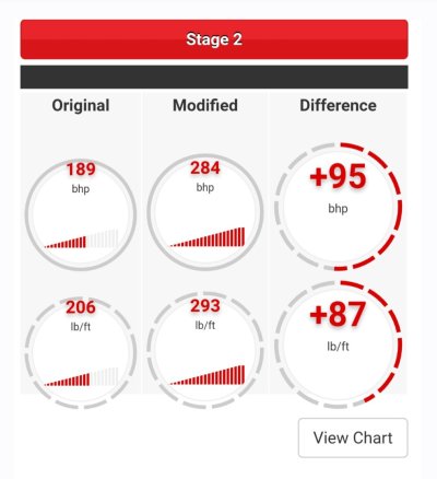

Looks like going Stage 2 has VERY good gains of around 70 hp and 205 Nm .
A E 280 is basically a detuned E 320 , so it then remaps to E 320 figures hense Stage 2 .
It will be 3 litres and a190 hp variant of the OM642
Correct this. Stage 2 will take it to 290 brake. (Stated) Which is the stage 1 for the E320.
So in my eyes it's safe to stage 2 immediately.

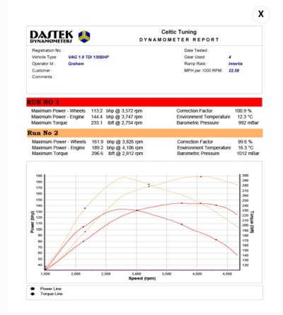

Who is giving the Stage 2 figures ?
Celtic - unles ive read it wrong - I mean at the wheel I reckon 250-260 which that 3.0l V6 should be able to handle easily - 190bhp is so underpowered for that lump
Beware of Celtic's inflated figures , I've caught them out !
Oh really, I did have a feeling the 290 figure was a bit steep, I usually use AK Performance after going on Celtic for a figure. Always been great!
They don't clarify that's at the engine do they... People think it's wheel horse power
They do , engine / flywheel is fine because that's what everyone quotes , including car manufacturers , the illusion is much more sinister .
Look again .
