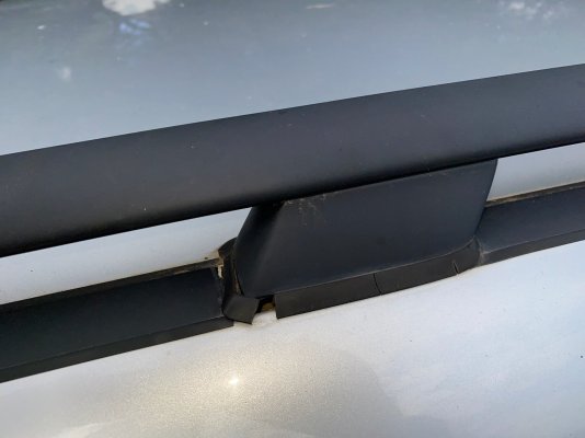

Also the rubber surrounds of the roof rail mounts have perished. Water I am sure is draining into the gutter below.
But I'm not sure it would all drain to the foot well? is there a drain hole for this rail somewere i could check?
The headliner is falling down but its not wet and shows no signs of being wet. It is booking in for a headliner replacement (it is from the heat in Spain's summers). Is it worth having the rubber rail trims replaced. Or might I open a can or worms if the roof rails are not leaking into the car directly? Some Sicaflex is an option.
