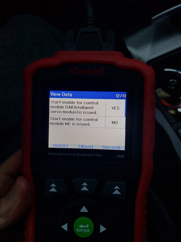

The fault code reader said the following information about the EZS/EIS module.

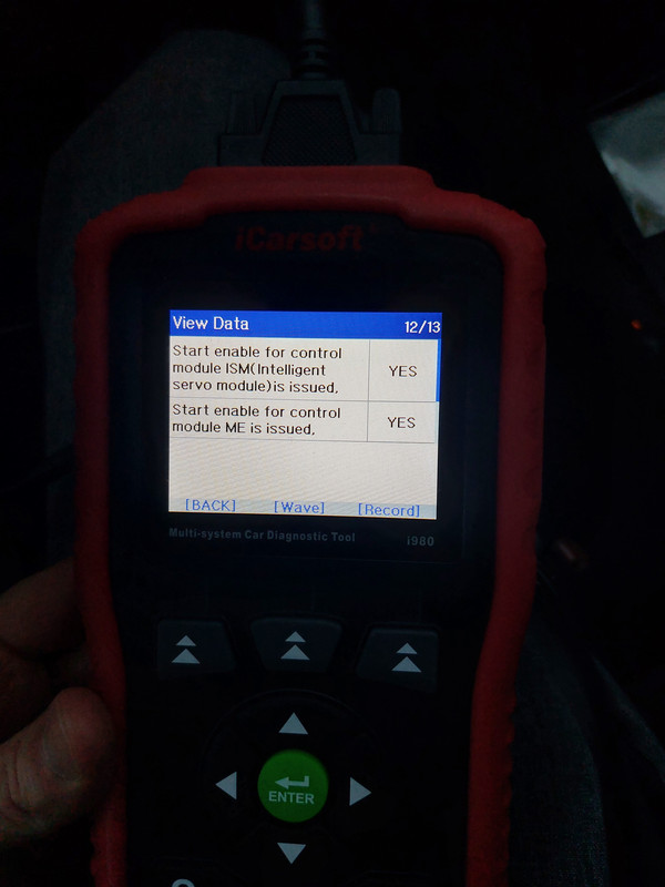

Finally, I tried alternately with two different keys, when after ten or more tries the glow light came on and the transfer pump made noise, the car started without any problem. After that the car ran and those instrument cluster texts disappeared, both keys worked repeatedly.
EZS/EIS said the following after the car finally started

Recharged battery, still same problems. Tried two differents keys, don't help. Switched between those two keys and tried to start.EZS/EIS "Start enable for control module ME is issued" is No.
After ten or more tries everything is working. EZS/EIS "Start enable for control module ME is issued" is YES and those messages from the odometer are gone.
