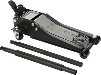

I’m tempted to get one of the Halfords 2 tonne low entry ones as only £55 and I get 8% off with my Alfa club. I’ve already got a Sealey 1.25 tonne motorsport low entry one for the Alfa but would like something a bit meatier for trying to lift the S212 on the central front jacking point.
Honestly it is worth spending more and getting a bigger jack with a wider base - they are so much more stable than the smaller DIY type of jacks. Something like this
It’s a good point, I’ve not looked at the Halfords one in the flesh yet to see how big it is. I only ever use them to lift enough to get the car on axle stands. The motorsport one I have is really stable as it has a big footprint, but the limit is only 1.25T.
Halfords have 10% off at the moment and you can use that on top of other discounts. So with a trade card I just picked this 3 tonne jack for £108, it's usually £160.
You can get the 2 tonne for under £90 if you have a trade card and use the extra 10%
