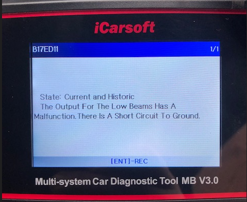

I have scanned the car using my iCarsoft v3.0 scanner (I'm just DIY so I don't have access to Star) and was presented with the following fault "State Current and Historic, The Output For The Low Beam Has A Malfunction. There Is A Short To Ground" not the most helpful message. The scanner also shows there is voltage getting to the unit, which I would expect as all the other lights in the headlight unit works.

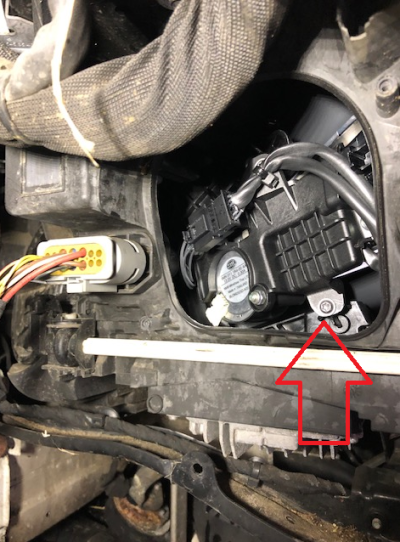

Access Panel (from within wheel arch):
I have taken off an access panel to the light to check if there was a bulb within the unit and I'm presented with this !
Apparently, its a fan for the light. I tried to remove this, to possibly a bulb, but failed as one of the screws is a 5 star bit, which I don't have.
