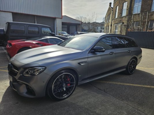

So it all happened yesterday!
What a thing! Very happy boy.
Big step up for me and still can't really believe I've done it.
Still got the C43 till tomorrow so couldn't resist a side by side 😎

Very nice, that matt paintwork is fantastic ! Great rims too ! Congratulations!
Thank you 😁 bloody luv it
